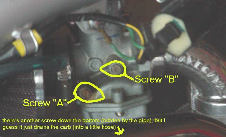

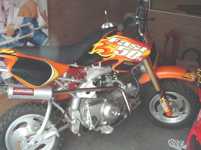

Ok.. so my 88cc fiddy is sputtering and popping when i ease of the gas after nailing it - I'm told I might be running too lean...
next question, which screw to turn, and which way.
a pretty basic question I know, but I really have never done any work whatsoever to gas motors. I am a fast learner and intend to get this right myself.
any help you can offer is much appreciated, specifically,
which of these screws does what?
cheers, rob
cheers, rob
Re: carb advice
Neither of those screws will fix your problem. You need to get a new main jet. Screw A is the idle mixture screw and only affects the mixture at idle to about 1/8th throttle. I'm not sure, but that one looks like it's an air screw so turning it in makes it richer. Screw B is the idle speed screw. Turning that in makes the bike idle faster.

that carb has an air screw you need one with a fuel screw get a better carb

also your air filter might need some oil on it,letting to much air by will cause it to run lean but it looks from the pic it is oiled properly look on the inside of it and make sure its got oil penetration all the way through
and you can screw in the air screw it might help as you said its shuting off the gas is where it is popping , depends on how much it is popping
