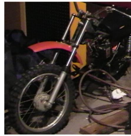

ive got one with the triple clamp and all ill sell ya
actually ill sell the whole mr fiddy was gonna make a cheater bike to combat the xrs cant tell you if it will bolt up but give me your measurments and ill breakout the tape and see if it adds up

Re: Who has applied fork springs? My c-clips STILL pop out
those are the ones. direct bolt on.
