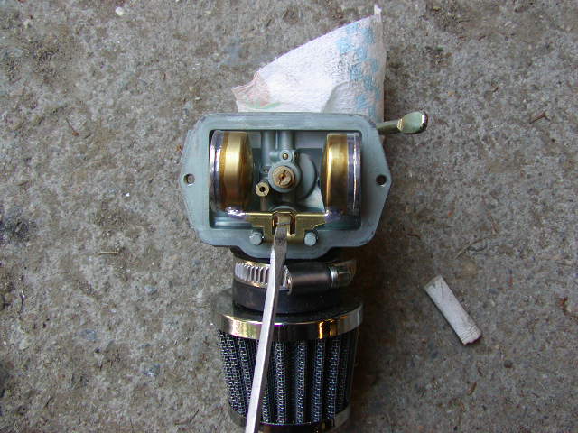

If you have the kitaco/keihin 20mm carb this is the float. Its at the bottom of the carb. To adjust it you need to break off the little tab that used to be where the tip of that screwdriver is pointing.

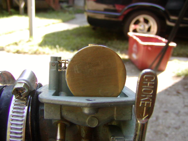

Now hold the carb upside down and measure from the lip on the carb to the top of the float.

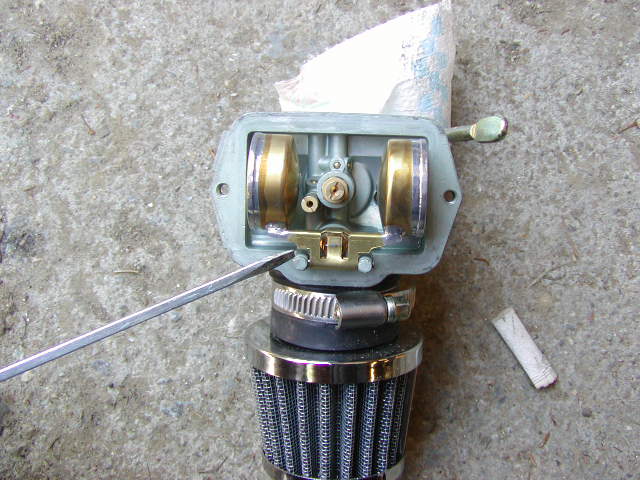

Now slightly bend down the little tab that I`m pointing to till the float is @2mm higher when held upside down. Intstall the carb back on the bike and test.
