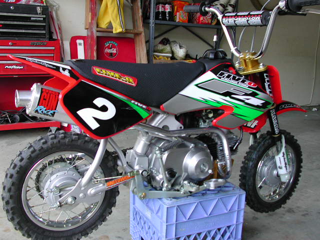

I-SHOCK all the way and fiveo high seat foam and cover is sweet i love mine........

nice rig!!
