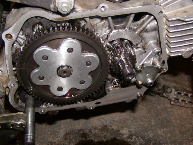

Ok, I had my clutch apart last night to install some heavy springs. Here are a few pics. I`ll try an explain how it all goes together. The first pic is a few steps into the install. Time didn`t allow me to take the whole thing apart.

The first thing you got to do is take all the stock stuff off including those two gears.There is a special tool for the clutch nut, But I use screwdriver and a hammer. Now you change out the shift shaft. Take the shift lever off then remove the phillips screw on the top left in the pic and the old shaft should slip right out. Install the new shaft, gears, and bushing. Then it should look something like this pic

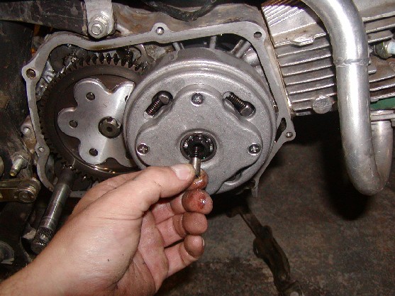

Slide the new clutch hub on the crankshaft. Make sure the splines on the back of the clutch hub is lined up with the ones on the small gear and push it on until you are sure it is seated all the way. Install lock ring, beveled washer, and nut. Tighten nut

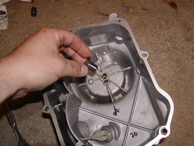

Next is to install the small cover. There is a sleeve that goes inside the bearing on the cover. The side with the offset whole faces in. Put on the cover and gasket. Then there is a small spring and a sleeve for it. Install it like in the pic.

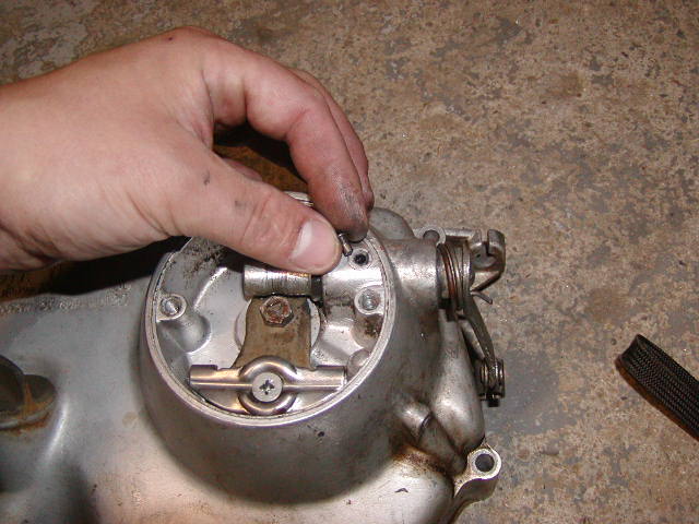

Next install the seals that go in the side cover. The put this sleeve in the back of the side cover. The tab on it goes in the square opening. Install side cover and gasket.
