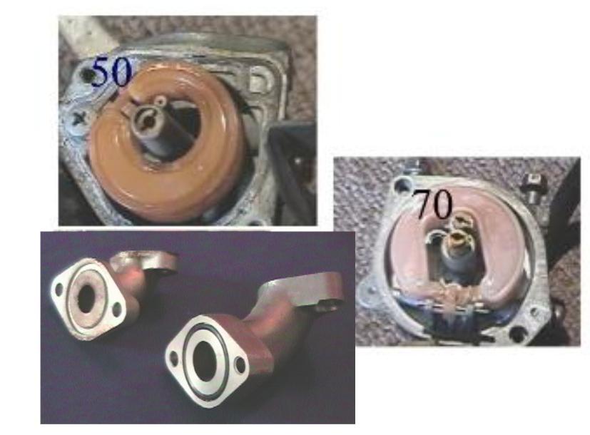

check out the different sizes of holes in the intakes one is a fiddy one a 70
the one on the left is the fiddy intake and you cant get your pinky into it the 70 intake you can stick your thumb into almost up to the second knuckle

Old Apr 21, 2005 | 05:42 PM
Fuscat's Avatar
Posts: 838
Re: 88 problems
HMMMMM big *** difference! hahah
I'm currently running the TB light 88kit. Does the same advice apply? You say stock pipe & airbox with 70 carb is that for a stock motor 50? Would changing to a 70 carb with the light 88 (cyl & piston only) require a pipe change anything else need to be changed with this configuration? What about running the bolt on air filter with the 88light and the 70 carb & intake and stock 50 pipe? I can't go back to stock airbox because of frame mods, my key is now in the way. I don't want to change pipes due to noise level and cost. I was thinking this could be an option to not change much or spend much but gain a pinch ?
