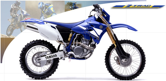

HOW THE WR450F 2-TRAC WORKS
The patented 2-Trac system uses a hydraulic pump situated on top of the gearbox, and a chain running in an oil bath drives the mechanism. The system pumps hydraulic fluid via high-pressure hoses to the front wheel hub which is fitted with a hydraulic motor equipped with a single gear. When the fluid has passed through the motor it passes through a filter and returns to the pump.
2-Trac is a ‘smart’ self-regulating system. Hydraulic pressure to the front wheel increases as the rear wheel loses traction on loose surfaces, and so the amount of power being transmitted to the front wheel is constantly changing so that the best ratio is always being applied. The front wheel can never spin faster than the rear wheel, and the amount of power transmitted to the front wheel is never greater than the wheel can use for traction. This self-regulating system also ensures that the hydraulic power supply to the front wheel is reduced as soon as the rear wheel regains full traction.
When the rider is coasting there is no power supplied to the front wheel – but if the throttle is opened sharply and the rear wheel starts to lose traction, the sudden increase in pump rotation speed boosts the fluid pressure within the system, and a significant proportion of the engine's power output is directed to the front wheel. If the rate of rear wheel spin continues to increase, the amount of power directed to the front wheel also increases, and so the proportion of engine power fed through to the front wheel is controlled by both the throttle position and the rear wheel's rate of spin.
