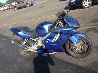

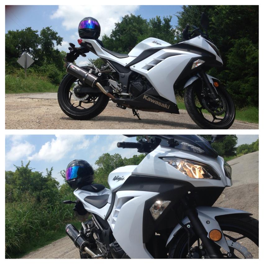

Hey everyone! My names Tyler and I'm semi-new to the whole motorcycle scene. I've been riding for about 2 months now, I started riding on a 2013 Ninja 300 for my first bike and I absolutely loved it. And i just recently got the chance to upgrade for a straight trade to a 04 CBR 600 F4i and of course I took the deal. The bike has been in the shop getting a couple minor things fixed but once its out I'm ready to begin stunting.
The bike has I think a Vortex sprocket which is geared (if i recall correctly) 1 up and 2 down... Pretty much what I'm asking is some help on what to buy to make my bike stunt ready. I'm very interested in learning wheelies so i want to know what makes it easier to wheelie and what not..

By the way here's a picture of my 300 and of my F4i.

Congrats, looks like a nice f4i
In order of upgrades I would say:
ASAP
Tip over mod
Clean air mod
Cage
RSC shorty clutch http://www.righteousstuntmetal.com/domestic/levers.html
oil change and fill to near top of sight glass when bike is level (stock is middle of sightglass) I go about 1/2-3/4 qt over stock, some go a full qt
Remove front upper plastic or all if you are really stunting. Add Acerbis headlight
good tires- Front at near stock 30
Nice to have- do after you get going
Round or 12 bar
Cut your exhaust to be a few inches shorter
Adjustable clip ons
Steel rearsets and shorty pegs
Subcage
Slightly higher gearing for lot riding (total of +8 to +12)
Griffy ignition advancer
Naarden saggy *** fix
When you get better
Foot in seat hole
handbrake and dual caliper setup
