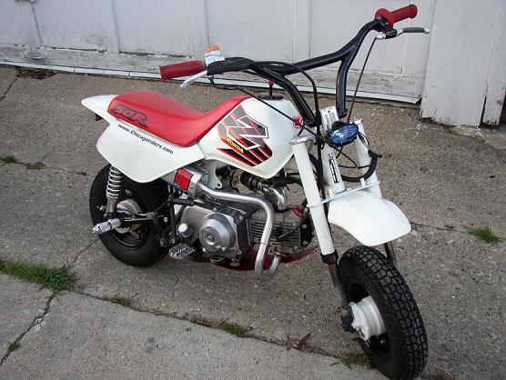

I think I was the first here to have a headlight on my 50. The stator is a Ricky stator.
How much output on that stator and is it DC or AC?
Old Nov 13, 2004 | 08:03 PM
Silver Surfer's Avatar
Posts: 1,335
From: Chicago, Illinois
Re: Best thing I have bought for my 50 yet.
[QUOTE=bikefrk]Here are the headlights. I need to paint the bracket after all the test fitting is done. Once that happens the fender and number plate go back on so it will look better. :YEAH
RICKYSTATOR 50 STATOR max output is 90 watts.
Be careful with that setup of 2 lights. I used to have 2 like you but one was just there for looks or an emergency when the other went out. Those Fog lights are 55 wats and X2 they are 110 watts which is way more than your 50 stator is designed to support at max load. Max load is 90 watts. You can use those dual lights together but you will have to use 35 watt H3 bulbs which are harder to find in a store but can be ordered from www.rickystator.com or any other GOOD auto parts store. Total output then will be 70 watts Going over a stators max load will lead to dim lights and premature burn out of the stator.
The Baja Designs is 110 output. You are correct. I need to get a 35w bulb. I will run the bottom light as the lo with the 35w and then the 55w as the high bulb. I was going to pick up some PIAA 35w lights but forget that,they were $115 for the set. :choke: :gasp:
