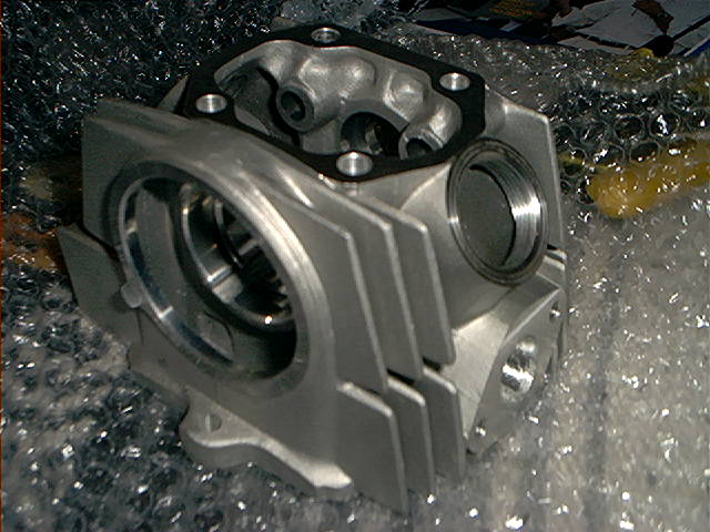

Valves..
in. 22mm
ex. 20mm
Ports..
in. 22mm
ex. 21mm

Does it come with a cam, rockers, valves adjusters. Pretty much is it complete?
cam is seperate. same cam as big bore with stock head though
