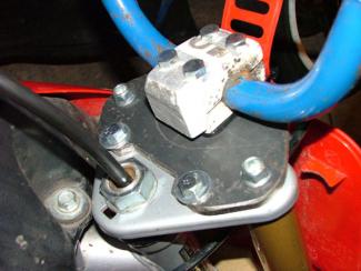

Buy bar clamps of a 4wheeler, like a 400ex or 300ex. Take of your stock bars off and bolt the clamps in the holes from the stock bars. I will try to take pictures tomorrow.
Mine look kind of like these
http://cgi.ebay.com/ebaymotors/ws/eB...sPageName=WDVW

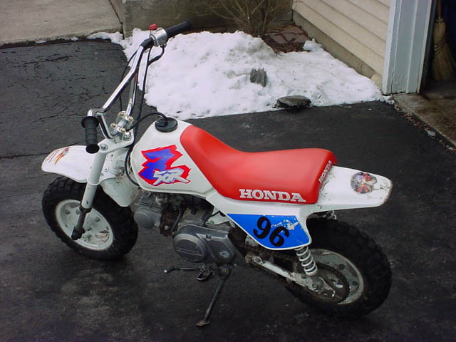

werd, total cost was $12 for the throttle tube and $7 for grips
Just wait till you guys see what i'm unleashing this weekend. ghetto-fabbed!!

$5 for the 400ex clamps
$20 for the bmx bar
the Z has 7/8 bar stock so I didn't need a different throttle tube, though
lol, i forgot the wicked bend that was in the bar when i got it....i stomped that straight the next day

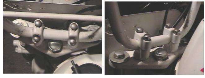

talk about ghetto stomp em flat
what you do when the bar whacks your leg?
go to the bike junk yard in your area look for an old 100 honda
sl xl and steal the handlebar clamps off of it
they will bolt right up and they will fit the bmx bars because 90% of all bars are the same size and you wont be fubaring your triple so if you ever have to put the stock bars back on they will bolt right back on
i wouldnt drill any holes in the triple you will weaken it and it will break eventually especially if you start jumping it
it is what i run with no probs spent 5 bux for the clamps
