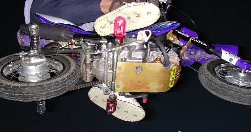

I got fed up with trying to find the axle so on the left side i used the chain guard hole drilled it to size and then matched it with the right side ... drilled it out in the same location just above the axle... work good... i think i used 1/2 from home depot for nuts and bolts

no just the opposite its hard to find the axle to fit the longer length you'll need plus it's like 12 or 14 mm which is a bitch to find
