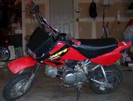

Winding the stator was really easy. Probably only took an hour or so to do. The acerbis headlight looks cool I think. It's really bright. Also, you dont NEED any special tools to get the flywheel off. I got a flywheel puller from the dealer but them basterds gave me the wrong one and i had to wait 2 weeks to get it anyway when they said it would be in in 3 or 4 days. But anyway....you can use a C-clamp to hold the flywheel while u take the nut off and to pop the flwywheel off just pry against the bottom of it with the screwdriver puttin the pressure on a bolt head in the lower right corner. This way you wont break anything.

yeah sorry but that hunchback seat is too much... but good work on the headlight, did you hook up a regulator or switch? it's a 55w headlight right?

Its got a voltage regulator ziptied to where the key went and a toggle switch ziptied to the bars. The headlight is actuallly a 35w high and low beam wired so they're both on.

i got the same headlight off ebay
how did you get it to mount up?
I have yet to put mine on and wind my stator
Old Mar 15, 2004 | 09:13 PM
sandmrider's Avatar
Posts: 319
From: st. louis
sandmrider is an unknown quantity at this point
Re: Got the headlight on and working! pics
I just made a spacer out of pvc pipe to make the fork tube diameter bigger then i strapped it on with the straps that came with it.

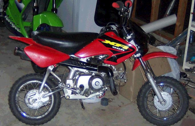

yo fiddy sits real high....what do you have done to it suspention and fork wise? do you have a ride height adjuster?

I got an i-shock and MR50 forks. It's about 2" taller front and rear. Just about perfect IMO.
