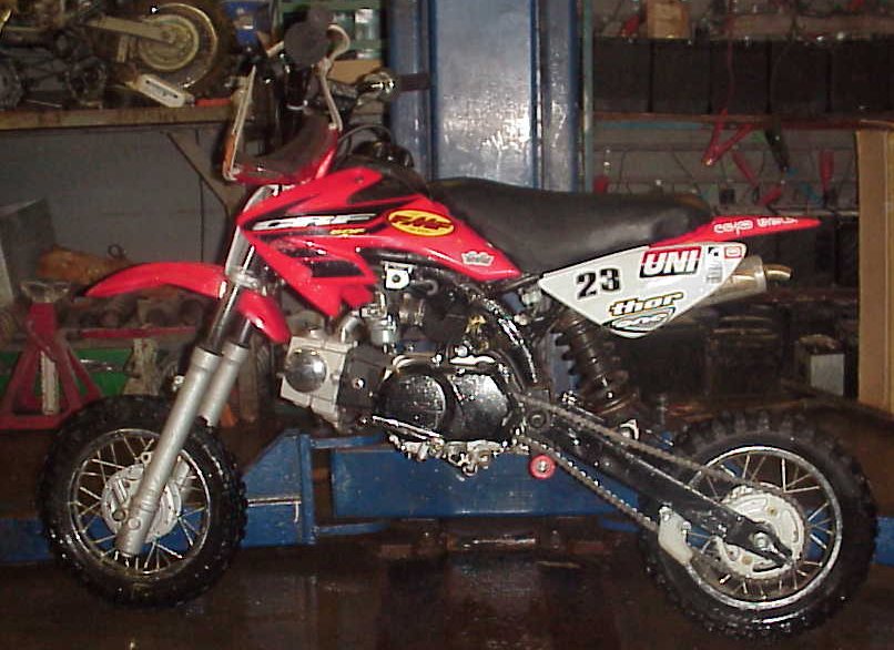

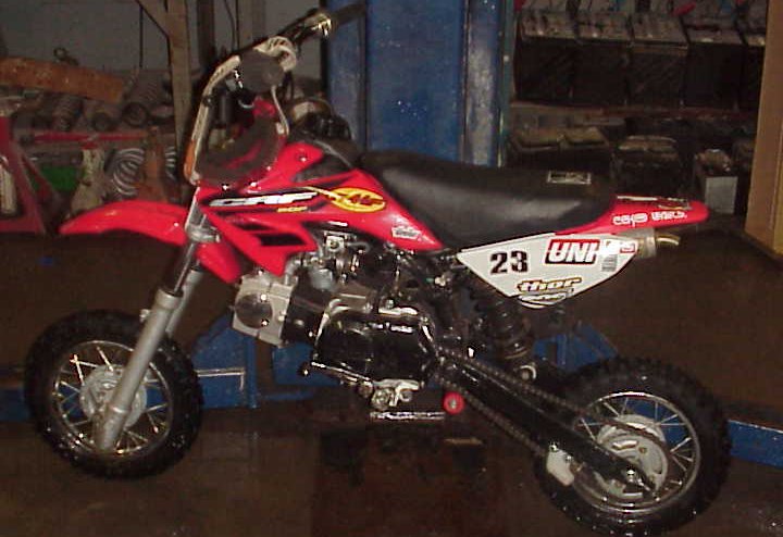

We are claiming to have the biggest 50 on SL. Think your 50 is bigger.. Bring it..
2004 CRF50
-2003 KTM SX65SR front forks
-2001 Polini Swingarm, Custom to fix an XR
-1992 GSXR 750 Rear suspension
-90cc 4 speed manual

It looks to me like you're trying to build a crf250 :D

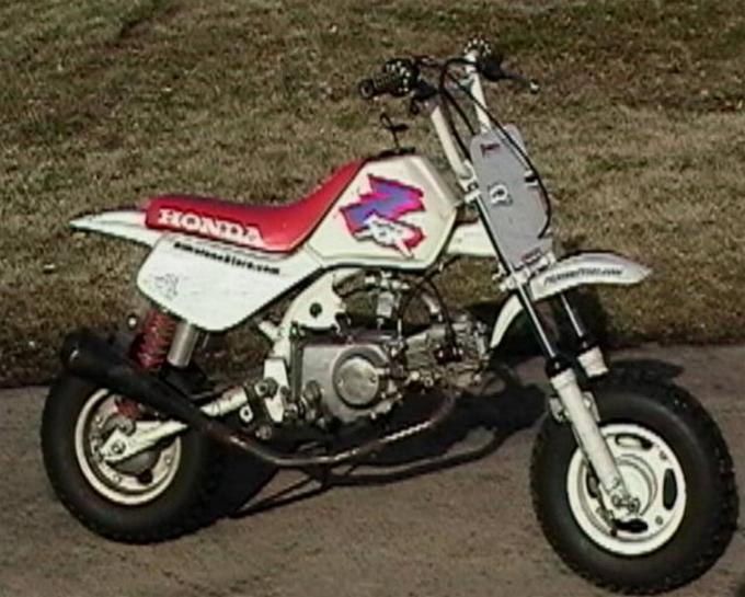

2004 CRF50
xl 70 ft forks
zb 50 triple clamps
xl70 swing arm
cr 80 shocks
100cc 4 speed manual

Thats a big z. What were the mods to make the fork work.. I cant find a fork for my z. The sl 70 isnt wide enough. Did the xl bolt right on..

king, the MR50 mod works on the Z as well, with the exception of the use of a CT70 triple clamp. im in the process of doing one right now.

I guess that i never tried an MR50 fork just the SL70 but the legs are too close. Can you tell me the width of a mr50

those are zb 50 front triples
the only mod was to add some aluminum spacers in the lower part of the clamp the 70 forks are like 1 mm skinnier than the zb's
i had to shave a lil bit off the hub to make it wider on the brake stay
and used the 70 front brake cable
i took a old aluminum fork brace and chopped it up for a cable stay
it bolts up where the fender bolt holes are

hey fab try those zb triples they are a lil more thicker and stronger lookin than the mr might be the same as ct though
not sure if your using the mr triples on the new xrs

Id def rather ride that z than kingof blings (no offenese kingofbling). It is more even and i wouldnt feel right wheeleing it.
