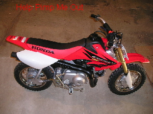

So I went and bought a fiddy yesterday. Brand new and I don't know what to do first. I am 6'1" and weight 210 you guys are the experts. What should I do to it first. I want to do the usually wheelies, some highchairs and endos. Hook me up with some mod help and some websites.

try this link, i think they have pretty much everything you need.
http://www.motoworldracing.com/xr50-minis.html
Im close to the same size as you and i would say you should start off by getting a big bar kit, and springs front and back.

also check the links section on www.50ccracing.com it's got everything...

bars, street tires, cheap rear hand brake kit for highchairs until you get the bp down, hd springs.....voila.....

https://www.stuntlife.com/forums/showthread.php?t=55217
Take it here......to this thread....
ALSO - note that Stuntlife on line store has everything that you need.
To start out cheap -
1. do rear spring rated @ 200 lbd - silver in color I think. need torch & open end wrench.
2. do front heavy duty springs.....need vice, channel locks, center punch.
3. Then later go for big bar kit that includes: bars, triple plate & clamp & full size throtle. *depending on bar height you may have to replace the throtle & brake cables with the 1" longer ones. **some kits include cables.
4. then you can do tires, grippy seat cover, fold-away/break away shifter & all kinds of stuff.
***Also - rear brake lever/pedal - we down here - bend ours out so that we get more foot on it - so to speak - but you have to bend it so it curves out after the foot peg, so that it still stays in line.
Good luck...
Fiddy on.

i would start off with a bar stiffer springs and maybe pegs
