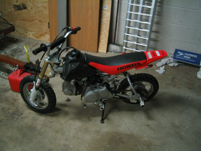

heres my ride butt naked, stripped her down for some work.

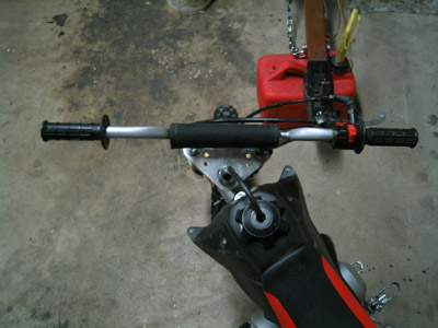

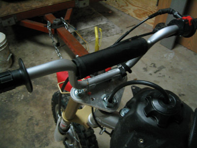

my bars bent straight

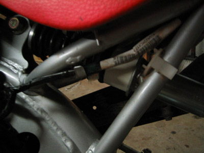

my shock mod...had the applied spring in there but that joint was way too hard.
stuck a spacer under the spring made it just right with a good feel.

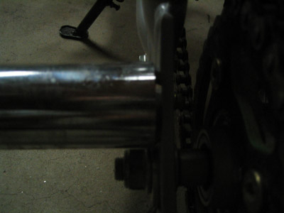

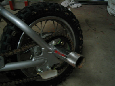

my Stunt Peg mod,
everyone has to get the Long *** bolt and maybe drill alittle.
i did something simple, just get the bolt that holds the chain guard, get a longer bolt and bolt the peg on.
holds strong. another hint, put the bolt off of the chainguard to the front fender and use the fender bolt for the peg...its alittle longer.

another angle to show how the front fender bolt is just perfect for it.
peg was 5 bucks at walmart (which i got for free actually) and i bash, scrape and land on the peg all the time with no problems. i didnt even have to get the bolt.

nice spacer mod...
did it give you a lift? did it raise the rear end?

nice spacer mod...
raises it so it wont go anymore and it feels JUST right .
applied racing spring was too damn hard. barely moved.
try it out.
