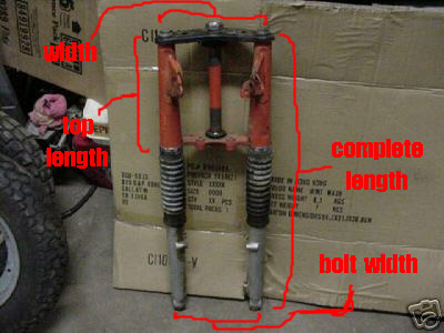

check these out...
its got standard forks off of a ct70, boots and triples.
do you all think this is junk?
Old Jan 12, 2004 | 07:54 AM
fab5fiddy's Avatar
Posts: 2,287
From: Cleveland,OH
fab5fiddy is a decent person
that **** is crap. the springs are just under those boots. there is no spring inside them. start with a set from an MR50. they work the best.
Old Jan 12, 2004 | 07:56 AM
spizz5's Avatar
Posts: 61
From: Frankfort Il
spizz5 is an unknown quantity at this point
yaeh dude thems junk. anything grease filled and not hydraulic dont waste your time.
