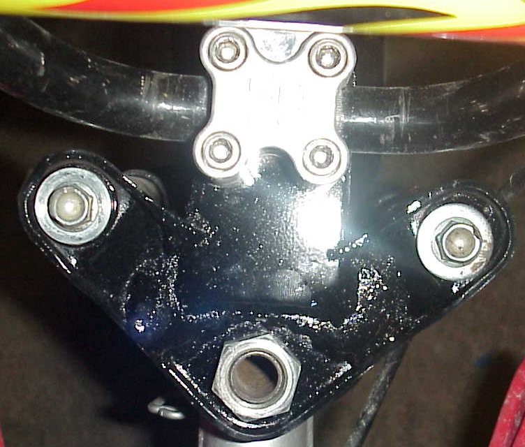

This is my triple that my dad fab'd. It is a stock kawasaki kdx80 with a piece of steel cut and welded and rienforced to hold the Fast50's clamp..

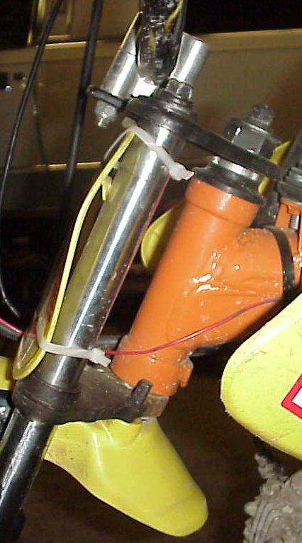

This is my Head tube showing the side of the forks and the triple trees. My dad cut the KDX fork stem out and welded in the stock Xr50 fork stem. It was a little short but works great..

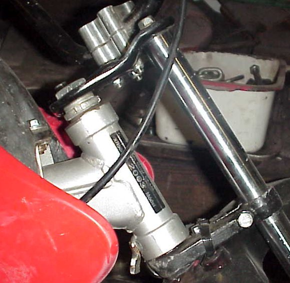

This is a sl 70 fork thats on a bike.. This fork has not been cut down and this bike has stock rear suspension. so the fork looks chopper style, but once its lifted in the back it will even out..
The stock triple was fliped over the make the fork legs higher and loose some of the space on the fork stem..

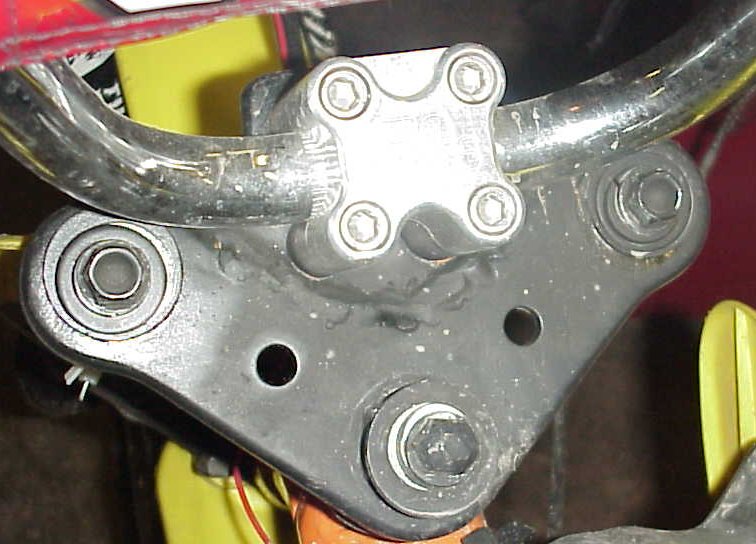

This is the triple, it was made with the stock triple and a piece of steel cut and welded and reinforced to accept the fast50's clamp..

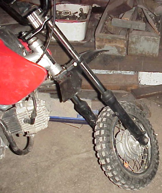

This is the rake of the fork. Like i said it needs rear suspension really bad.
