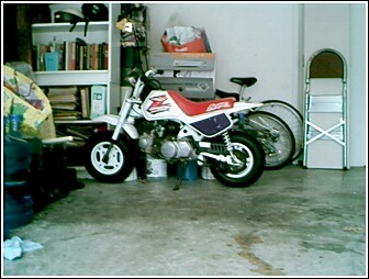

i have a 1995 Z50 I abuse the Hell out of it. every time i come in to the pits or something I lose a bolt, or both holding the bars on. How can I fix this? I thighten em up untill its about to crack, lockright didnt help. any ideas?

i have?

Are you talking about the bolts that clmap to the bars or the triple tree? I had the same problems on my 79 z50. come to find out the threads were stripped out so i had a friend take the bolts out and machine new ones into place.
