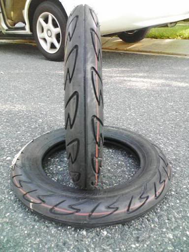

Here's a pic of the 2.75 tires I got
I am going to pick up an 05 fifty from someone on the site tomorrow, and he said the 3 x 10 are really the way to go. Yeah you have to add a few links to the chain but it makes stunting a lot easiear.

Those 2.75 tires will do fine . Alot of people say 3 x 10 are hard to do circles with . Taller sidewall . Some say the size you have (2.75) are better . It's just a preference . In your other threads you said you are just learning so these tires are ok . They are fine for straight wheelies . When you wear the rear 2.75 tire out , and want to try a 3 x 10 , do it then .
