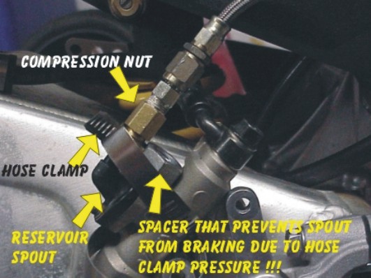

Ok. I have had many people PM me asking for some pics of my Hand Brake setup. I guess cause its Cheap ( like $6.00 for materials) + 48" steel braibed line + Lever of your choice. By the way on the 3rd pick make it JB Quick. Same thing, JB Weld but it dries in 5 Minutes. Set it on start molding it after like 1.5 minutes like if it was clay, Then within 5 minutes total time is dry.
Havent had any problems with this setup. The only disadvantage on this setup compared to a double caliper is that you need to fully realese on lever before pressing the other one. But it works good!!!
Check it out!!!,

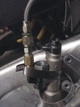

picture #2

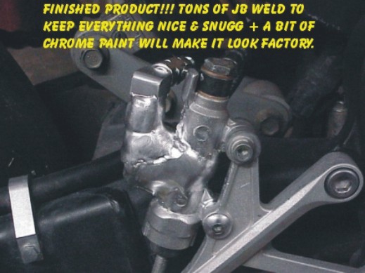

PIcture # 3

I Agree with You & A lot of other people. Also there is that one that Merk Recommended too or is it the same?? They are only like $200. + they are more reliable being machined that way!!! My method is somewhat unsafe! You got to keep in mind that if your doing a trick that requires the HB & you are depending on it & it breaks for whatever reason, your bike is shooting back & **** could go wrong!! I personally would rather have one of those that Merk Recommended but this works for now!!!

No Sir. Works Very well for me! As long as is bled good. After your brake pads wear out more than ½ way then I crack my reservoir to realease the vacumm pressure since I keep my reservoir full to the brim, Therefore there is no air to allow the cilynder from the rear caliper stay as close to the rotor as possible, since once you use either one of your pedals & release it, it brings the cylinder back to stock position or it doesnt allow it to self adjust. Does that make sence??
