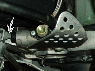

if this was for me i got a pic so you can check it out
Man the offset between your mastercylinder and piston is huge!! You got the right year stuff on this thing???

Re: Another hand break question
OIC your rearsets are bent to He!l
i hope its the right stuff i just got the bike and thats how he had it set up and i been bleeding and playin w/ it to try to make it stronger
I was looking at the bottom picture you posted. Where the piston (Threaded rod, with pivot) goes into the cylinder. Looks a little bent. Sometimes it gets like that if the rearsets are bent. If your foot brake doesn't bind up your ok.
See picture
yea i just looked at it , it is bent so im going to check that and see what happens but thank...
