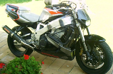

For your clutch line get a 919 cable from honda. It will be cheaper than barnett and will come in quicker, as well as being the right length. The 919 had hi-bars to begin with. I'm running one on mine, and know of other doing the same.
