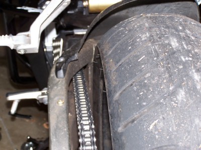

Re: i used search... what sprockets on 954 dont rub subframe
i running 15/57 on my 954, no where near the swingarm. i really like the gearing mostly use 2nd gear, but I wish i would have went with a51 or 53 tooth instead.
pics of my 57toof cog.
ID:	94445   Click image for larger version
thanks a lot
55 tooth should be fine then!! :YEAH
