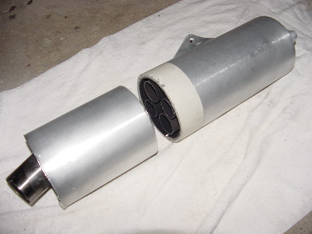

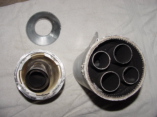

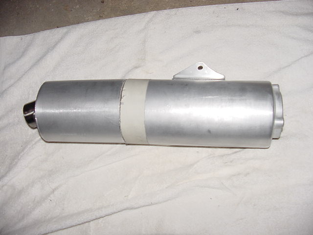

I was experimenting last week and cut a stock can open but went straight through it, I cut it at the same distance back from the mount point toward the rear as there is from the mount point toward the front of the can. Now I have all those pipes in there and no way to reweld the end cap and also use those pipes the way they should be routed. I wish I had known better what the inside looked like before hand but oh well. I want to keep the bike quiet so any advise would be helpful. I attached pictures of what I did so far.
Thanks.
Any other pics of that can Bam?

anthony, BIG ups for those pics man, you rule
now... in the top middle pic.... do those 4 pipes just end and all flow out into teh muffler, and out of the 1 pipe? im trying to study these pics a bit more of not how to make a mistake like you did. shoudl i just cut around teh muffler?

All of the pipes were longer than that. The one at the top runs all the way through and was connected to the rear and out the back, the other ones were longer and there are now a couple 2-3 inch pieces laying on the garage floor. So no, I didn't just happen to cut it at the end of those pipes, I cut them off when I made the cut.
The exhaust I think travels into the back of the can from one of those tubes and into the rear open part of the canister, then travels through 2 more of them, through a baffle and into a forward part of the canister, then finally through the last pipe at the top, through the baffle again and out the back.
This is why a stock can is so quiet. An aftermarket is usually a straight tube from the front to the rear wrapped in packing, at least everyone of them I repacked was, much easier design to modify. They are also easier to deal with because of the rivets and the ability to just rivet the end cap back on. I wan't to retain some or most of the quietness of the stock exhaust so I am trying this experiment on an extra can I have, picked it up for $5! I have a welder than can reweld this back together but right now I am perplexed as to what to cut next to be able to keep the original baffle and tubes intact. Looking at the top pic, if I take about 4 inches off the rear section and reweld that last 2-3 inches back on to the frint, it may be my best bet. Still I am not sure how to reattach that one pipe that runs through and out the back end. (I am ususally really good at this types of problems!)
Hopefully someone that has a very shortene stock looking canister, like Bam, can answer that, since it was obviously no trouble for them.
Also if you did this with a stock can, how much louder is it? If Bam's sounds like a D&D or something, then this is not the route I am looking to go. If it is louder than stock but just a little, this it what I am trying to achieve.
The quieter I am the less people will complain at the spots I practice at and the longer I will be able to get away with it.
Thanks all! :YEAH
