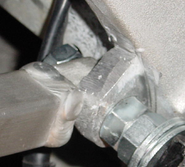

I cracked my right subframe tab right off after a 12 go bad on my gsxr1000. I had the local welder remake the tab on the frame but alot bigger and thicker than the original. It has held up fine since then. I will be taking my frame in over winter to get the rest of this shiat azz Suzuki tabs reinforced.
I have included a pic of the new tab......
It aint pretty but if you're worried about looks you are on the wrong website....lol
Cheers
