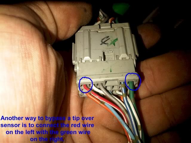

I have a 2001 f4i, i tried doing the tip-over bypass today and now both of my blinkers and hibeams are "on" on the gauge, while the headlights appear to be off.
This is what i followed.. Name:  new.jpg

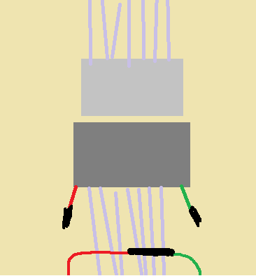

And ended up with this Name:  LeAsXzg.png

After the issue came up and looking at the wiring diagram and some other forum source it seems i should've linked another wire instead of just splicing them...

Welp i'm retarded. Here's how it should've been. http://stuntride.com/vbstunt/showthr...-Sensor-Bypass

that green wire is the ground, for everything up front. If youre planning to keep your lights, you dont want to jump the TOS there in the main wiring harness. You want to do it further up in the front sub-harness. The connector will only have 3 wires. Red, White, and Green.
