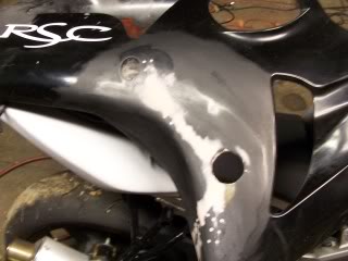

so this thread is for my little buddy mdub4life29 he asked me how i repair broken plastics...after a brief explanation, he replied "i need a step by step"..lol so Dub ...here ya go

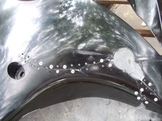

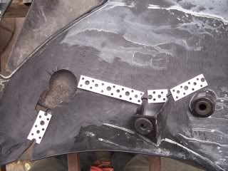

use plumbers tape and drill 1/8" holes in it, drill the holes before you cut the tape..much easier

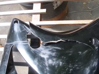

pre cut the tape to fit your damage

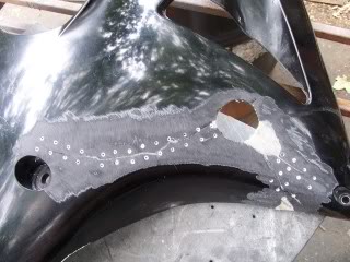

use a single rivet in each piece to secure it before drilling an other holes line up the tape as best you can to cover the damage and give you as much bite as posible for each rivet, drill a second hole and fill w/ another rivet to secure tape from moveing.

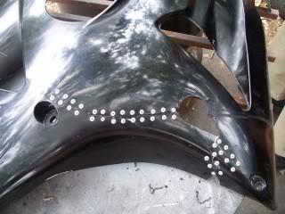

once you have all pieces secured in place w/ two rivets you can finnish drilling all the holes and fill w/ rivets

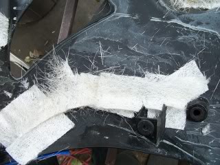

grind the area to be repaired so your f.glass will have something to stick to (this can also be done before any rivets are used) then pre cut pieces of f.glass to cover damage area

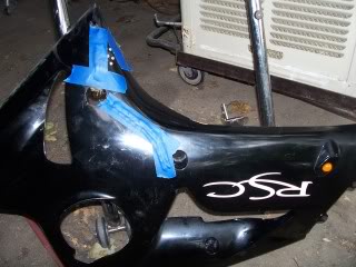

i used tape on the front side to keep the resin from running out and help to fill voids,clean area to be repaired w/ laquer thinner of other chemical that doesnt leave any residue. mix up you resin according to the directions and useing a diposable brush apply to damage and then lay the glass matting, dont skimp on the resin...but dont mix more than you can use in about 5 mins or it will be wasted.

after you glass has hrdened you can peel the tape and useing the same 1/8" drill bit , drill JUST the HEADS of the rivets off, then grind or sand damaged area to give the body filler something to stick to

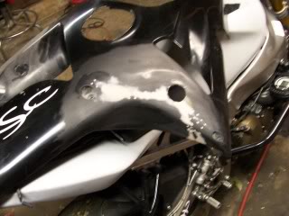

again clean area befor applying body filler
then sand, i used 120, then 220, then 320....prime and paint....

not my fairing dub...i have race glass. it is steel tape you buy it at the hardwaere store, its called"plumbers tape" its usually used to secure or hang pipe to the wall. the repair is stronger than the original body parts imo. and if you use some feather fill automotive primer it helps hold any filler in so it doesnt crack and fall out. and to make your body work perfect its not in the bondo work its in the sanding of the primer...... really you just get it close to perfect w/bondo. of coarse you cant make bondo too thick...the thinner the better. its regular ol bondo from auto zone or any paint store.

i have fixed several f4i tails like this and neve had a prob again... works good! the only reason this fairing broke is cause my buddy didnt drill a big enouph hole for the lower cross bar and it put pressure on the fairing...it wont break again...lol

it works awsome, stronger than before.....
