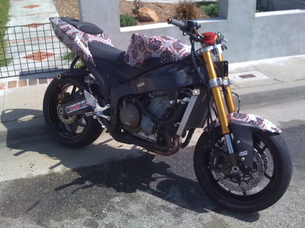

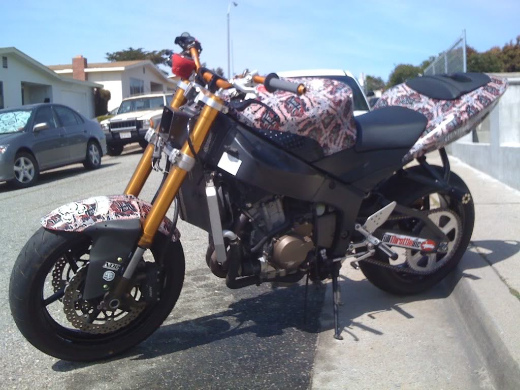

THATS THE SMOG BOX/CHARCOAL CAN. IF YOU DO THE KLEEN AIR MOD ON YOUR BIKE IT WILL GET RID OF THAT. YOU CAN FIND PIC'S HERE IN THE SEARCH BOXI DID THAT MOD AND TUCKED MY WIRES ON THE OTHER SIDE....
