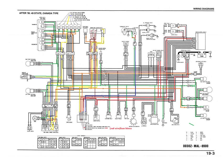

here is a wire diagram... im not done but ill post it when i am.... i think it might be a ground issue... i noticed there is not a green(ground) wire hooked up to the headlight..the headlight only has 2 wires cuz its not the original.. i'm gonna try hooking it up to one of those.. there is also a ground at the fan motor, im gonna check that too
Name:	f3 color wire diagram.jpg

It would be simple and easy to check them both... if you just disconnect them both, do you still blow the fuse? I couldnt see how you would blow a fuse from a ground not being connected.
