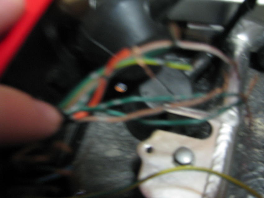

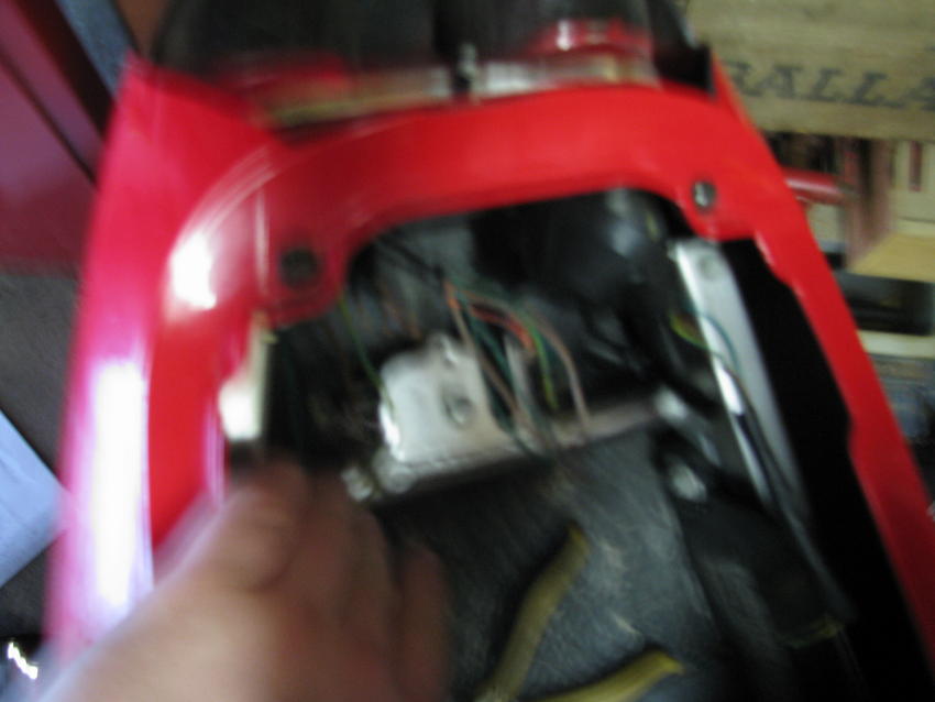

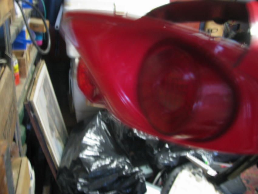

Hey guys the moron who owned the bike for me cut all these wires. I have been looking over the electric diagrams for my bike but I am having trouble figuring this out. There are two tail lights each tail light has a y/g, g, br wire coming out. I am trying to figure out how to wire the blinker brake and regular lights that run all the time into this.
You'll need a trailer wiring adapter to integrate the blinkers unless there are electronics built into the light. It converts 6 lights to 4 lights.
Thats what I thought I threw out that piece because thats what was broken. Can you point me to the direction of where I can buy the correct one for this application?
