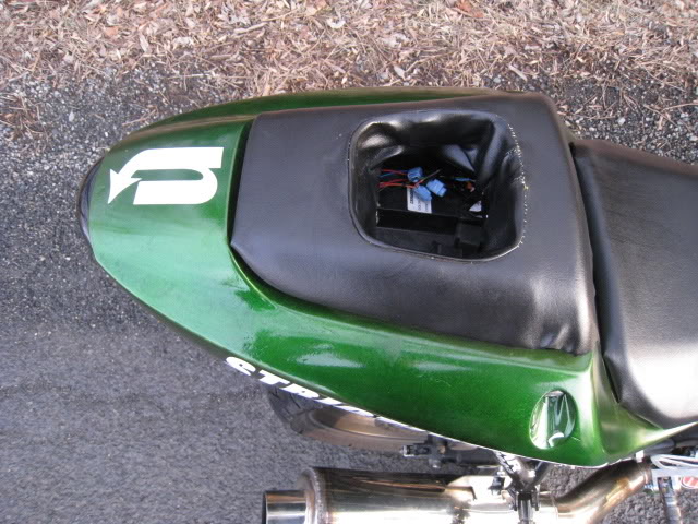

i took the stock seat cover off, cut the foam, cut the seat pan...
measured new vinyl to match the stock seat cover. matched it up and cut hole out of new vinyl to match the seat hole.
Then i took extra vinyl and sowed around the hole in the new vinyl. And put it all on

i used new vinyl. Marine vinyl, like they use for boat seats.

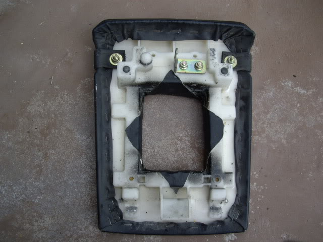

if you dont redo it, the way I did mine was to measure out where I wanted to cut the hole out and cut v's into the middle if the square from corner to middle, corner to middleand folded the flaps in afterwards

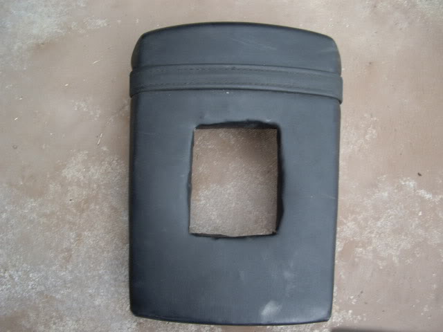

on my old R1 i didnt take my seat apart , just cut through the foam,cut a X in the material and then glued in back together

**** that hole looks a little narrow like your foot might get stuck I like the glue though holding the vinyl down.
