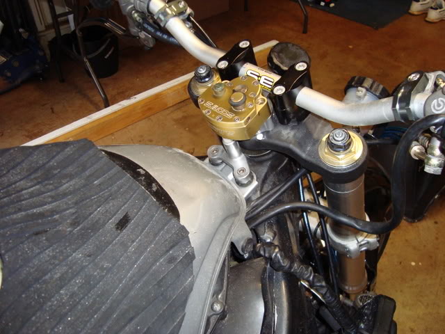

will a scotts stabilizer fit with dirt bars on my f4i ? probably just need some taller risers right?

mount it backwards. or as the moto x rider would call it sub mount.

hell ya i just ordered one today

i used the tag bar mounts from hai.... the mounting holes are offset, so it'll push the bar even more forward... drilled the mount holes on the tripple as far forward as possible with jus barely a corner of the mount poking out. but if in doubt mock it up first... oh wait are you already runnin db bars???
i used a flat arm an jus adjusted the pin a little... jus be sure your damper is fairly new, cause the old ones like 3 years ago didn't have a flat bottom, so the reverse mount wouldn't work unless you get a stepped arm...

ya i already have db bars but i have a new top triple so im going to switch out triples when i get the stabilizer because my bars are drilled into the triple pretty far back.

oh, ok.. your all set then... an i doubt anyone makes this, but i'm also going to make a custom bracket that bolts to the 3 unused holes to mount the damper. instead of the reg stem nut wit set screws mounting bracket... i'll post pics whenever i get around to it... kinna hard to do home jobs at my work, but i'm gonna dimension it out today so i can at least start on it....
