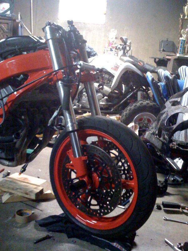

Youll need:
929/954 race and bearings (AllBallz kit for 929/954)
929/954 upper/lower tripple (or any other 50mm upper and lower - rc51/1000rr)
929/954 wheel and rotors (or machine the f4i wheel, but still need the rotors)
929/954 fender
929/954 forks
929/954 axel and spacers
I just redid the whole front end on my bike, the guy I got it from kept the f4i bearings in, and the lower tripple will hit and crack the frame if not swapped out
