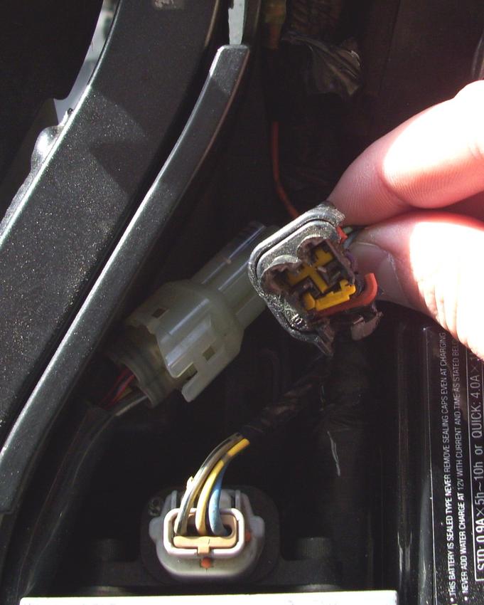

Old Jan 6, 2009 | 06:54 PM
DEBO's Avatar
Posts: 4,714
From: The Bay
DEBO is a decent person
Re: How do I check codes on the 05-06 636
When I got this bike the subframe was broke into 2 pieces.
Not sure what this plug is for??? NEED HELP FI light is on.

Old Jan 6, 2009 | 09:05 PM
sdfkillz's Avatar
Joined: Apr 2005
Posts: 6,766
From: NY/Bmore
looks like the plug where u do the jumper mod. nothing plugs into it, its just capped off.
