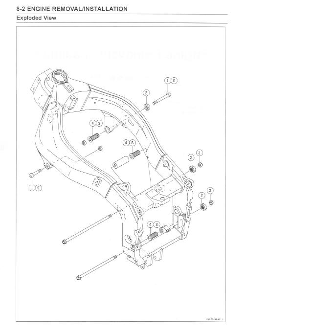

Hi, I just picked up an 06 636, and whoever had it lost most of the motor mount bolts. It looks like there is some sort of adjustment sleeve that is suppose to go inbetween the motor and the frame ear, I was wondering if there is one on each side in the front or just on the one side. Pics or info would be greatly appreciated.

You are correct in the adjustment collars go in-between the frame and the engine. They are only on the right side of the engine. The engine is adjusted to be flush to the left side.
Hope that helps.
**edit** Just noticed you have an 06, this diagram is from an 03-04. I'm not sure if they are exactly the same, but I'd probably have to guess they are real similar.

Thats what it looked like in the parts diagram but I was not sure. I rather be safe then sorry. The idiot before me had just a bolt in the right side and the motor jumps around, rear sprocket is toasted and missing teeth because the motor isn't mounted right. Thanks for your help
