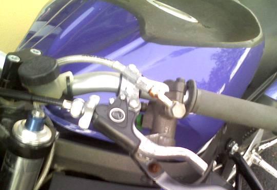

i used the ppg and rattle can bed liner too:YEAH turned out great.
im at work right now but the only picture ive got on my phone is a shitty one.. you can barely see the tank.

mines held up great. it got rained on a couple of times while i was at work and water stayed in the dish part and it chipped away some of the bedliner but its only a few bucks to respray it!

i used duplicolor..all i have is a cover for my bike that lets rain through it. so when it would rain while i was at work, i would get home hours later and there would be water filling up the dent. it has happened so much that the bed liner has started bubbling up and chipping. that and i had a leaky gas cap for a couple of weeks as well...so with a mixture of gas and water accumulating in the dent it has chipped it.
