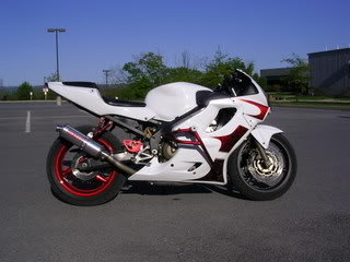

my back rim is auto paint..looks great and washes easy,,but the downfall is when it chips... it chips and can keep on chipping....

here it is before i painted my bike camo...Name:  DSCN3303.jpg
Old Nov 16, 2007 | 12:10 PM
damn the whole bike looks awesome. the rear rim looks great. i think i'm going to go ahead and paint it then. if it chips over time, i'll just do it again. i'll see what some other people say first though. thanks, havok.

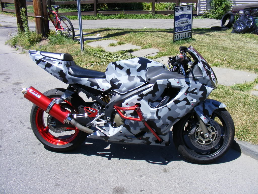

alil closerName:  DSCF0276.jpg

Re: rims: paint vs powder coat?
oh ****, i totally remember talking to you about that camo paint and how u did it cuz i wanted to learn. man, it's been a slow start but i've started with small ****, like my old scraped up clutch cover, to practice not making the paint run and ****. considering it was my first time, i did a pretty good job at making it look a factory paint job. i still have a couple of questions regarding your stencils but i'll pm ya those.
