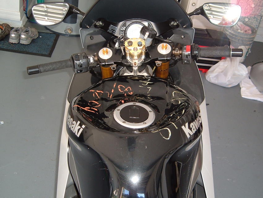

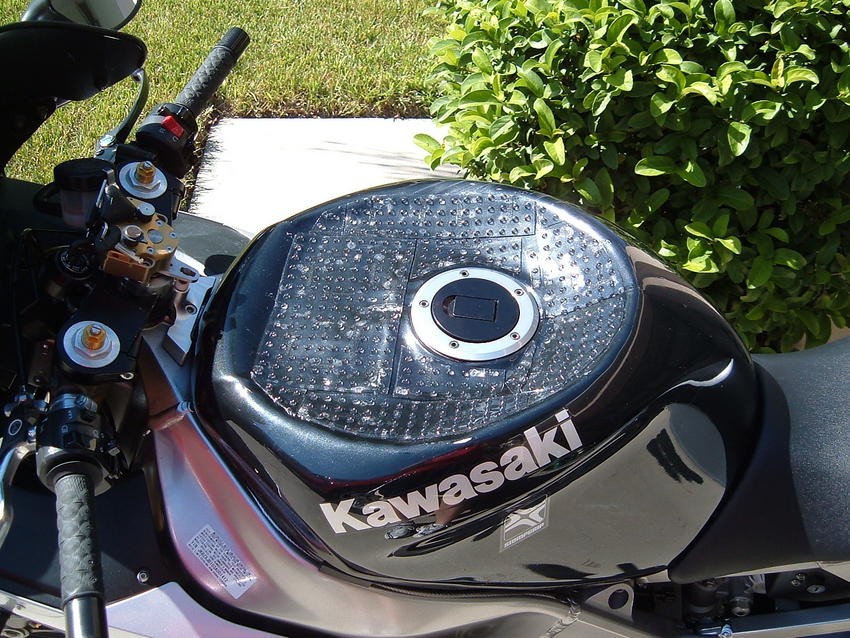

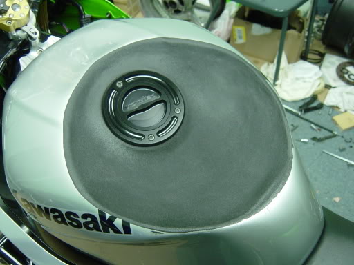

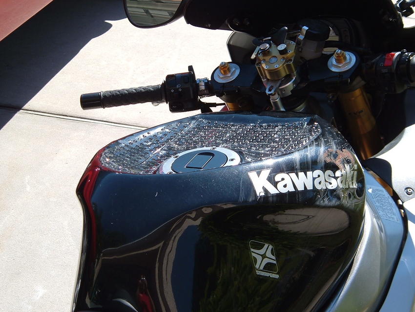

This is how Im gettin down. Any feedback would be fantastic!
ID:	202189   Click image for larger version
ID:	202190   Click image for larger version
ID:	202191   Click image for larger version

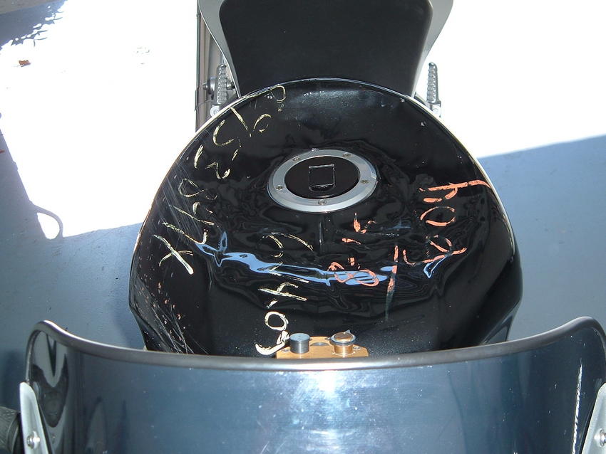

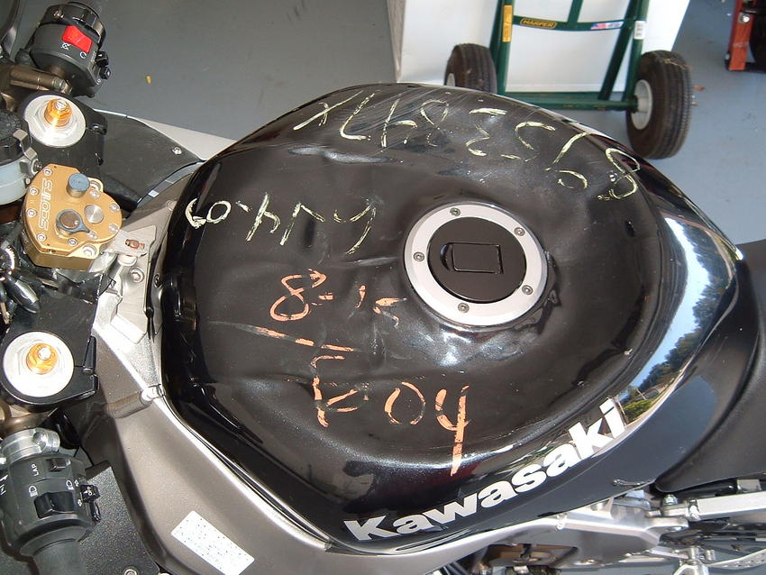

Just finished. I hope it works. I took all the tid bits of info from stuntlife and a few other sites and here it the result...
ID:	202196   Click image for larger version
Old Nov 9, 2007 | 01:12 PM
JohnnyP's Avatar
Posts: 3,289
From: Toronto
JohnnyP is a decent person
Re: 636 Tank Dent And Frame Polished
Looks like you didnt cut out the splash guard under the cap, and thats why your cap area wont go down anymore. If you cut that out first it doesnt bottom out on the inside of the tank and stop the cap area from going down more.......Its also a bitch to get gas in the tank with it bottomed out..
Old Nov 9, 2007 | 01:17 PM
IRISH MIKE's Avatar
Throttle choppin'
Posts: 4,156
From: O-Town
Splash guard? How would I have done that before I dented? And it is going to be a pain in the *** to get gas in. Its totally bottomed out.
