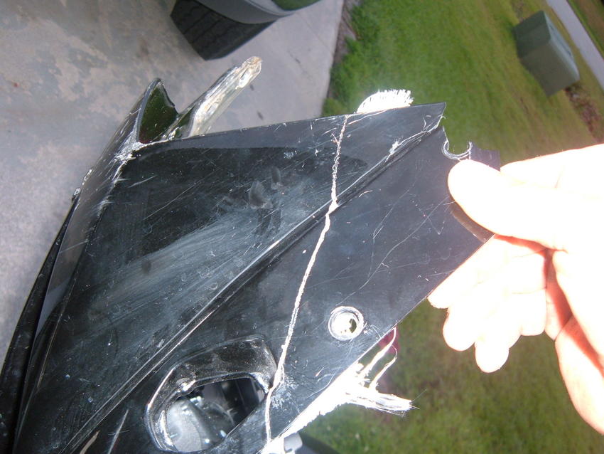

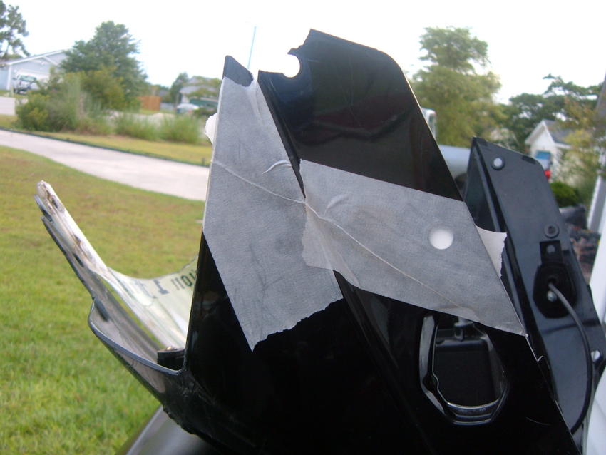

how to fix platics
put all the pieces back in to there proper places and secure with tape on the out side(the side you want to be pretty)

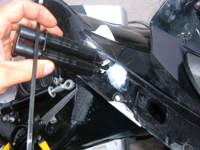

Re: how to fix platics

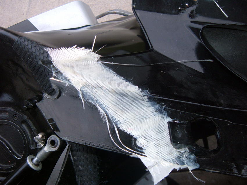

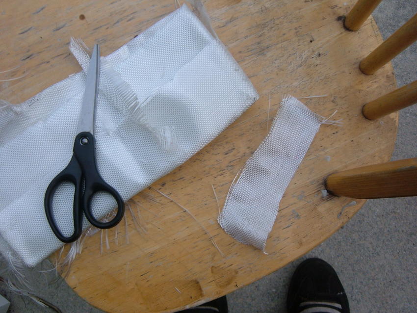

cut strips of fiber-mat,, that fit over the breaks,,
mix up the two-part epoxy plastic weld and spread it out making shur it fills in the cracks
lay the fiber-mat on the areas to cove it all, and smooth out all air bubbles,

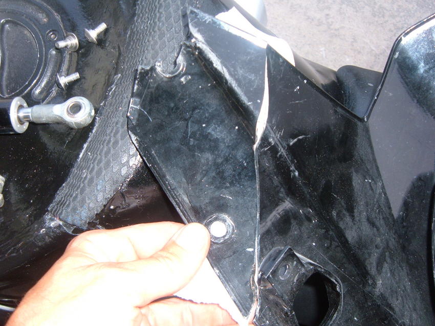

lay the fiber-mat on the areas to cove it all, and smooth out all air bubbles,and add more epoxy on top, spread evenly

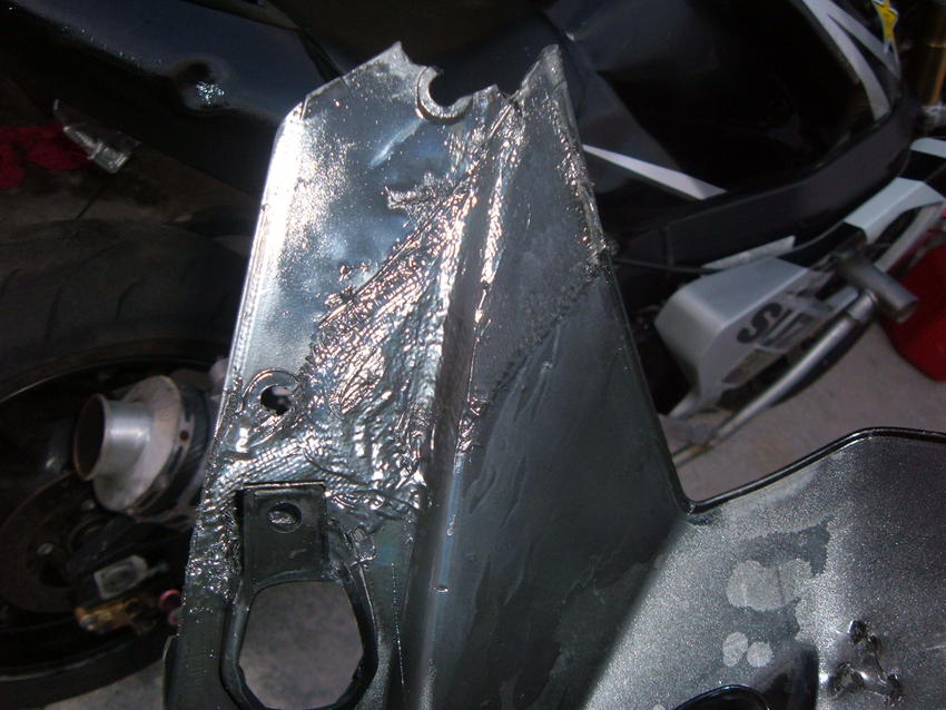

remove tape,,,,,,
cut of any lose edges,(i used a air cut-off wheel)
paint and your done
