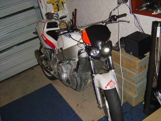

Pic #1:
Bike without exhaust.

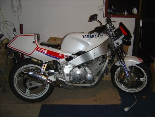

Pic #7:
Side view of my bike with the shorty exhaust. When I do a tail chop, it'll look good.
