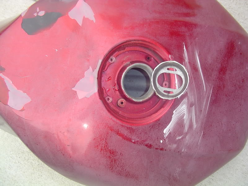

Old Aug 19, 2007 | 01:04 AM
TL MILLER's Avatar
Joined: Nov 2005
Posts: 1,685
From: Fort Collins,CO
TL MILLER is an unknown quantity at this point
Re: 636 tank issue
Originally Posted by JohnnyP
Thats why I always cut that splash guard out before you start denting
are you talkingg about the litte bs metal right under the gas cap
Old Aug 19, 2007 | 07:15 PM
TL MILLER's Avatar
Joined: Nov 2005
Posts: 1,685
Re: 636 tank issue
Nevermind
Old Aug 19, 2007 | 09:20 PM
babyJOKER's Avatar
Posts: 1,281
From: Milwaukee,WI
babyJOKER is an unknown quantity at this point
Re: 636 tank issue
Originally Posted by TL MILLER
Nevermind
how did u cut that out ?
Old Aug 19, 2007 | 09:27 PM
TL MILLER's Avatar
Joined: Nov 2005
Posts: 1,685
Re: 636 tank issue
used a dremel with some metal discs. took all of 2 minutes. just pull that part out the bottom and make sure you wash the tank out afterwords
Old Aug 19, 2007 | 09:33 PM
babyJOKER's Avatar
Posts: 1,281
From: Milwaukee,WI
Re: 636 tank issue
thanks i got 3 636 tanks that need to be cut !!!
