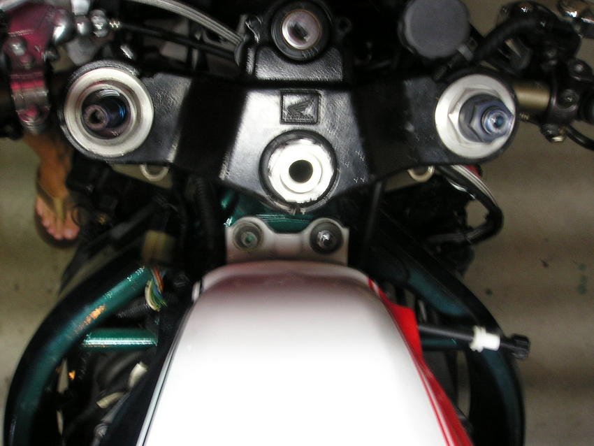

Ok, this is as far as I made it... please help.
The picture on the left I have already removed the cap that goes around the damper rod, now how do I get the whole rod out. And how much do internals usually go for?

Re: Siezed adjusters on forks
  • This is what you need to UN screw
  • This is the preload, this is what compresses your fork spring when tightend
  • This is your damper rod, it ajust how fast the fluid moves through a valve to stop your fork from compressing to fast
Thanks for the color coded arrows. But my problem is when I unscrew the top of the fork tube (the red arrow) once it gets to the last thread it almost sounds likes something is holding it in, almost as if you were loosening a bolt but kept pushing in on it at the same time... I can see all the threads are exposed but it just won't pull out. Is there something else in there holding it in place?
yes a locking nut, slowly lower your front end..
Lower it all the way down, or just until there is a little bit of pressure on the forks?
i run motul 15 weight in all my ****... just incase i wanna go really stiff... if your valves are ajusted properly... fork weight doesn't matter...
lower your front end and the internals will pop out.. under the fork cap theres a locking nut that stops the fork caps from un-screwing... it looks like 929 forks have a white spring coller, you may have to pull it down to see the locking nut.
