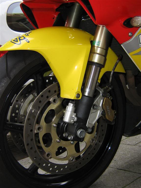

Re: RC51 forkoil, how much??
like this: Name:  IMG_0636Large.jpg
Looks nasty! Did you use stock rim, rotors and calipers? What all did you have to change to make it fit?
Old Jun 18, 2007 | 05:53 PM
da Liks's Avatar
Posts: 4,142
From: Rotterdamn Europe
da Liks is a decent person
its a rc51 rim with rotors, rc51 axle, rc 51 forks. then the stock f4i calipers and 954 triples. fits like a glove. if you keep FF then the bolts on the lower triple hit the back of the headlight. so i cut some stuff away. and maybe weld up the stops on the lower triple but that's it!

Originally Posted by nags
those are 929/954 calipers
Nope! Stock caliper with stock color on a F Sport Rossi color. Picture
by the way, your front fender just bolted right on ? that's nice !
thats an RC51 fender!! and the f4i calipers from his rossi f4i!

those brakes look kinda small on them big *** rotors imo, but im sure its gonna work out for ya
