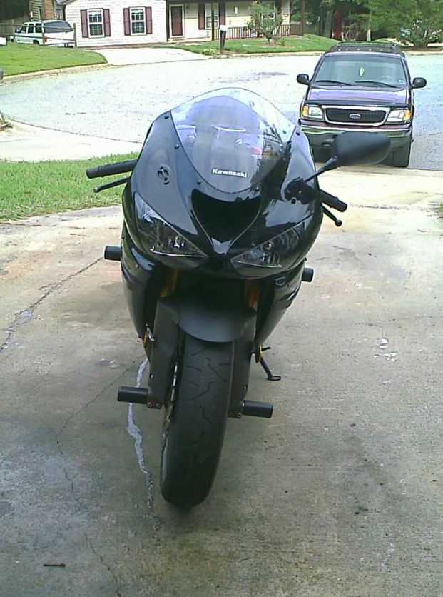

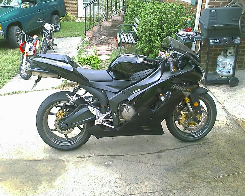

I just used threaded rod and frame sliders on mine -- about $50 total for front and rear.
Name:	05 636 Right Side.jpg
ID:	195641   Click image for larger version
Name:	05 636 Front.jpg
