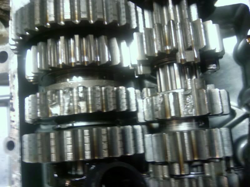

i got it all apart and 2 gears where bad... :YEAH vary happy that only that only 2 gears parts will be here monday so can be out monday night
here is a pic of the gears

Damn you fucked that **** up. What did you do to break two teeth?? Cltuchless up shifts?

was doing a burnout in my garage and poped out of gear

If All You Replace Is Those Busted Gears It Wont Fix The Problem. You Need To Replace The Drum And Forks.

The drum and forks are fine

IF BEEN THERE, DONE THAT. WHAT IS YOUR CONCLUSION TO WHY IT HAPPENED THEN? DOOWATCHYOULIKE AND GOOD LUCK.
