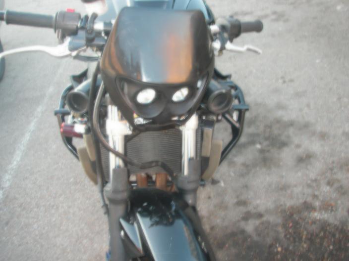

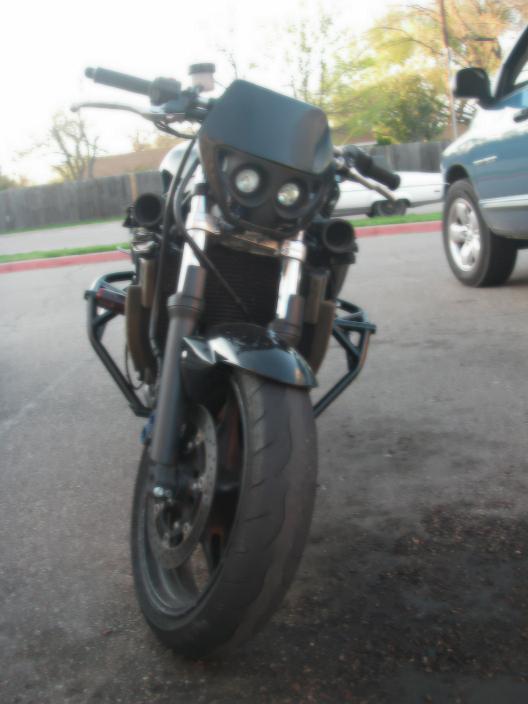

my acerbis headlight has a bracket on one side to help hol the harness in place behind it
you can't see it in the pics but my entire harness is behing the headlight and it looks clean
i did re-wrap the wires and they don't rub on the frame or forks
