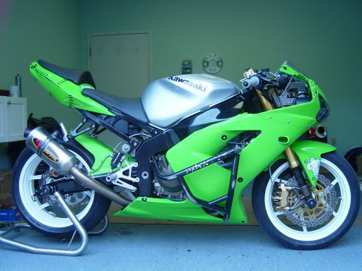

well u see the pictures of my bike and its lowerd 1 inch... u can just flip the top tripple clamp and wha la

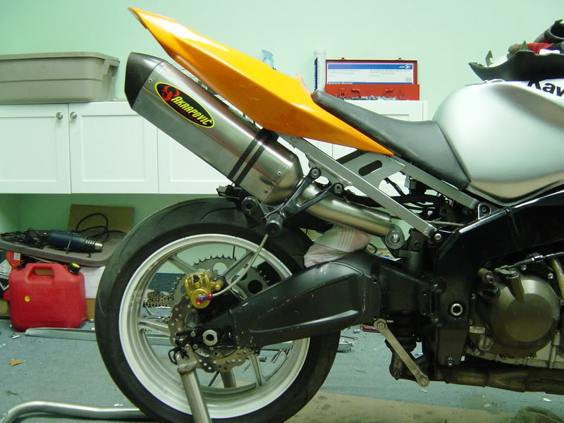

I was going to try and use the 05 tripples and forks when I did my wheel swap, but they use a different fender mounting location and I didnt have a fender so I passed on the forks. But from what I gathered everything looked swapable, **** I just bolted on the 05 swingarm and only had to swap 1 seal.

wow...im loving that 03 with the newer wheels and the swingarm...def different i like it alot...major props:YEAH
