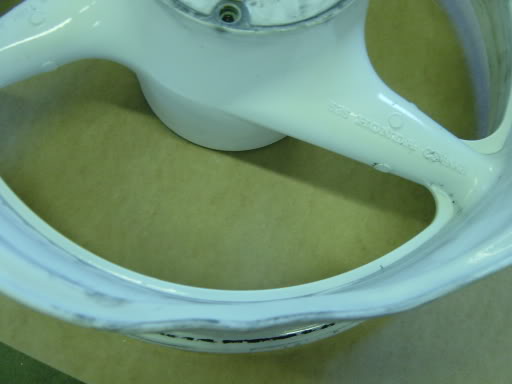

I'll never waste money fixing a rim ever again, the dents just come back so much easier after its been straightened. And they come back much worse!..

Depends how bad it is I guess mine's not that bad you can barely see a lump. The air just leaks all around.
