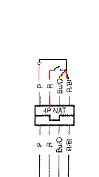

Power comes from Red, so if you're gonna have a switch, put it there.
Blue/Yellow and Red/Black get soldered together
That should leave only the pink wire that goes to the ecu. You need to put a diode on there, I think 7 volts is what the ecu wants (if i rmember correctly)
check out my kick *** wiring diagram

MikeM you are a genius
p.s thats a wicked wiring diagram
i heard it from niner, i cant take the credit
